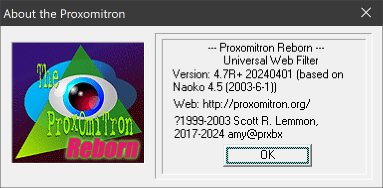

更新到4700R
Proxomitron Reborn.png (20.11 KiB) Viewed 27306 times
