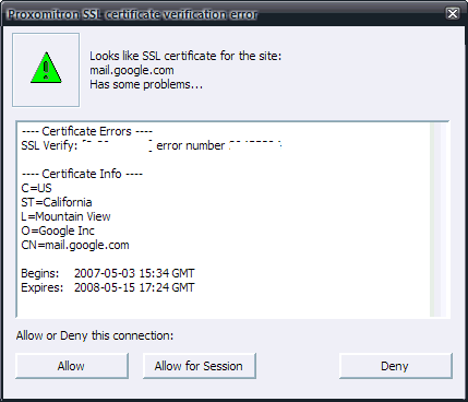

睡之前再发个帖子询问下,本来想自己研究的;可该去开睡,也没时间了 :(
浏览需 SSL 认证的网站,如何把一些这类https的网站加入到安全名单中?比如 gmail, DRL 之类的网站,也就是不出现下面那图的提示。sidki 规则中又有没特定的规则文件对此进行设定的?

sidki的规则我没用,不知道是否有相应的文件。但在他的帮助里提到过的,因为https的地址一般是带port的,如
gmail.google.com:443/,这样的,所以你要在bypass里写入
gmail.google.com:
注意有冒号,这是通用方法。好像还提到过half-ssl,这个我没仔细看,LZ可以研究一下。
另外要说的是,gmail里是有广告的,所以要过滤https的gmail,直接bypass上面那个地址不行的(因为我过滤gmail的广告是用的url kill,bypass了整个地址就过滤不了了),如果用文本替换的方式,我倒是没试过

Re: 浏览 https 类网站问题
如果你用sidki的规则,看看Config_Control.txt里,启用half-SSL即可解决
2.2 Use Half-SSL (off)
If active, secure links (https://) get redirected or converted to a Proxomitron
URL command (http://https..).
Pro: You may save some time because Proxomitron doesn't need to re-encrypt
the document after filtering - and the browser doesn't need to decrypt
it.
You don't get a warning message in Mozilla and Opera, saying that
Proxomitron's certificate doesn't match the site in question.
Contra: The browser is completely unaware that it is dealing with a secure
page. All responsibility goes to Proxomitron. You may not feel
comfortable with this fact.
This option requires a URL-based Proxomitron command.
Do *not* check "Disable URL-based Proxomitron commands", under
"Config -> Access" in Proxomitron's main window.
Proxomitron *must* have access to the SSL DLLs. The browser's HTTPS proxy
setting will not matter when this technique is in effect.
